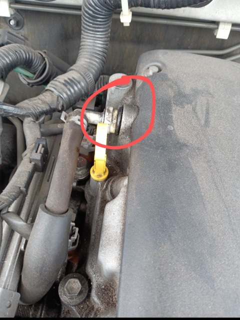

What is this part called?
05 Jul 2022 23:47 #243957
by JimnyZh
What is this part called? was created by JimnyZh

The white L shaped fitting ? Looks like a PCV (Positive Crankcase Ventilation) valve - they are engine specific so if you're replacing it, make sure you get the correct one.

The white thing is the PCV as said ^^^^^.
They are not the tightest of fit into the cam cover, it's likely it's the cam cover seal that shrunk with heat, hence a little loose. So look at replacing the seal, assuming it's not part of the PCV, if you feel this needs to be done.
