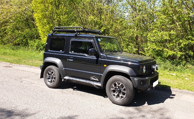

I have the Thule roof bars, they are the same as the Suzuki offering but about a third of the price if you shop around. I also got an aluminium roof basket which is very light weight, that I can use with the roof bars.A good And versatile option in my opinion.

A roof system can be fitted and left in place, in its simplest form (Thule Aero Bars or similar) its not adding much weight or drag.
However, in its simplest form, its awkward to attach cases and possible to damage the vehicle roof during attempts to balance the cases on two bars. For this reason a roof rack cage is better, you can just throw the cases on top and tie down. The down side is the rack cage is heavy and adds drag / wind noise and is not something you can quickly fit to the vehicle.
A towbar system such as the Thule EasyBase is easy to fit if you have a towbar, but the combined cost of the two items is expensive. The maximum noise weight limit on the tow bar will be dictated by the towbar system manufacturer/ Thule, but its typically in the region of 50 - 75KG for towing. The down side of these systems is you will forget its fitted and eventually reverse into something !
If you can remember its fitted I suspect this could be the best solution for the airport run.
A taxi ? - why not. Its a good idea if its infrequent use and they tend to be reliable. The down side is you need to make small talk to the driver and the journey will range from sedate to Death Race 2000.
I went for an adventure roof cargo system as I needed a space to throw wet camping equipment quickly onto the vehicle. Its perfect for my needs, but has added slight wind noise. I've not seen a noticeable increase in MPG but suspect one must exist simply as its added weight and drag.
