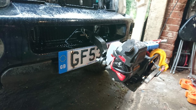

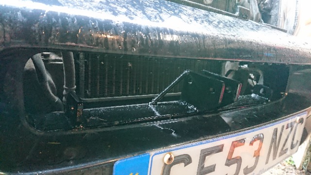

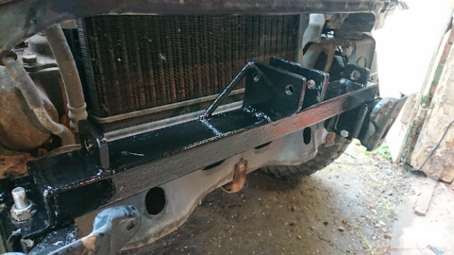

Along similar lines heres the "hidden" bracket I made for a detachable front towbar. It includes a pair of recovery points for shackles but is obviously much more substantial than what you're looking for.
Re. The load limit for lifting eyes, remember that lifting kit has a minimum 5:1 safety factory, compared to 2:1 for recovery kit. So a 1t lifting eye would be rated atleast a 2.5t recovery point. A pair of these will be more than adequate on a Jimny.
