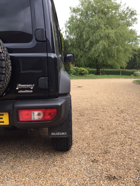

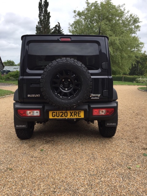

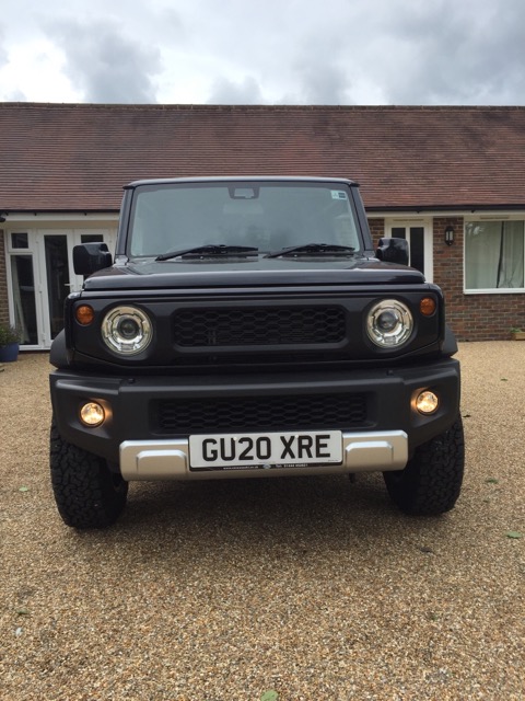

If this helps anyone I have these fitted on my Gen4 Jimny.
(7x15 -14 offset wheels and BFG 215/75/15 tyres):
jimnystyle.com/collections/wheels/produc...o-15-wheels?variant= 37451304599717
Here is a couple of photos of the front/rear:

Hi DJ20.
I have been considering replacing my front grill with the type you have fitted on your Jimny and would be grateful if you advised me as to where you got yours from.
Roger
Roger
27 Jul 2021 08:47 #237025
by DJ20
Replied by DJ20 on topic Big Rim Size - 17”
Hi Roger,
Grill came from Jimnystyle, here’s the link:
jimnystyle.com/collections/styling/produ...or-suzuki-jimny-2018
