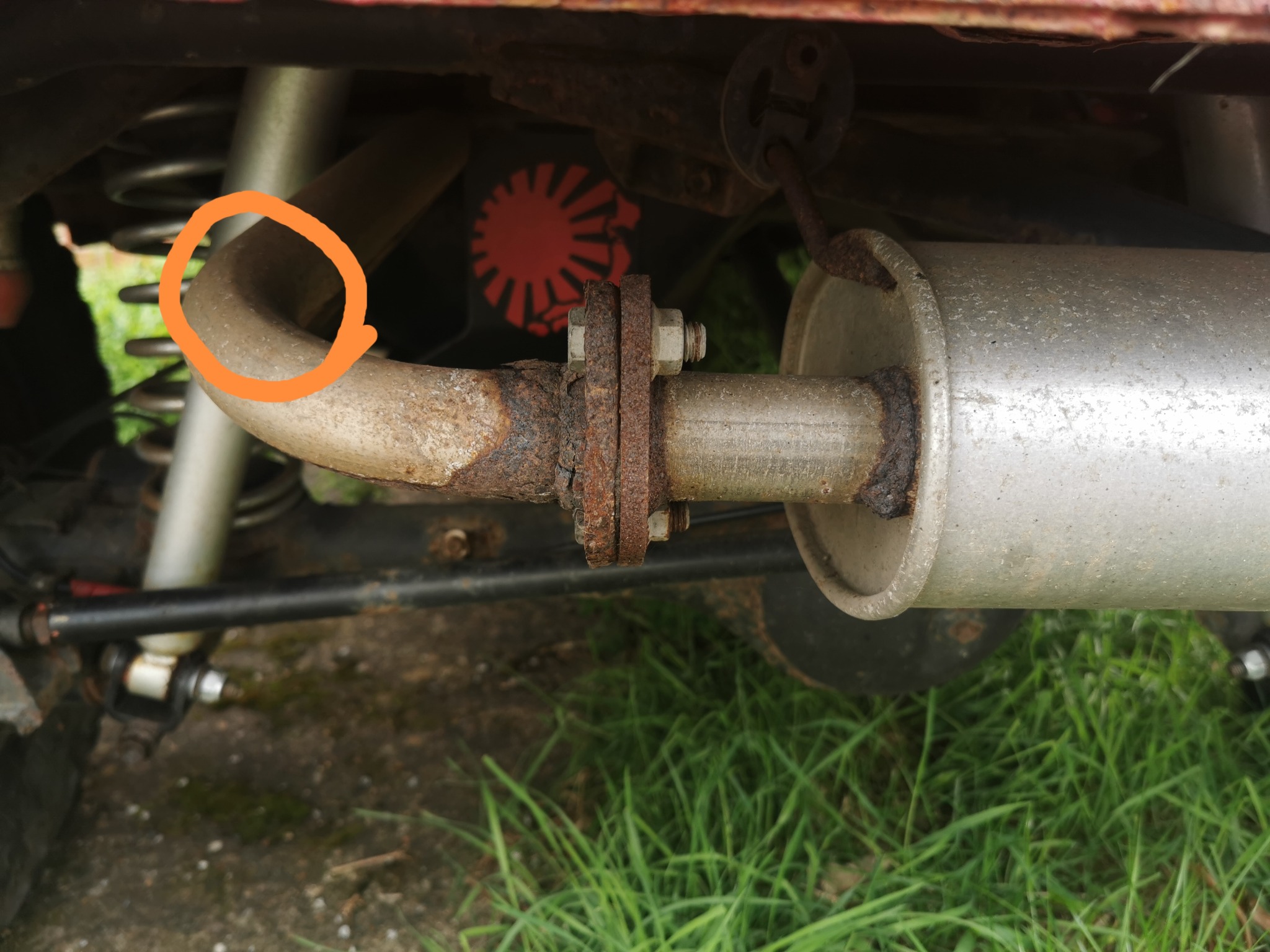

18 Apr 2025 16:58 #260157
by Paul4A
1999 T registered Jimny. Early G13BB SOHC engine.
Replied by Paul4A on topic Exhaust design changes
No eBay APP ID and/or Cert ID defined in Kunena configurationNo eBay APP ID and/or Cert ID defined in Kunena configurationI’m about to change the exhaust back box / silencer again (I think it’s partly blocked after a cat breakdown). My question is, do the projections on these two options from eBay look correct? They seem to have a few mm of pipe sticking out which is more than on the existing silencer.
19 Apr 2025 10:56 #260159
Replied by jackonlyjack on topic Exhaust design changes
One has the flange going straight into the silencer other has a flange near the orange circle
Different manufacturers may have different size silencers. But only 2 types of mounting flanges
The following user(s) said Thank You: Paul4A
