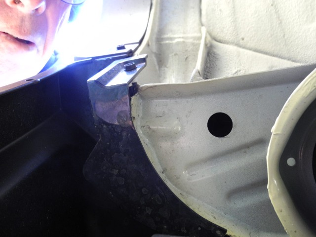

Micheal wrote: Humble Pie!
It's a mouse problem. First time had a chance to take a good look under the bonnet and the critturs have stripped a fair bit of wiring insulation, inside they've also had a go at an area behind the passenger front seat.
Can't see any obvious hole they're getting inside from though.
I reckon a new wiring loom is going to be needed as well as other 'consumables', this is going to be an expensive repair so will need to look at insurance claim.
The wiring insulation does look very thin compared to stuff I'm used to like on a landrover. I saw that Toyota were sued in USA over this issue when they switched from petroleum based plastic insulation to soy. Rodents turned out to view the soy based insulation as a free snack. I wonder if Suzuki use the same material.
Question is how to stop this happening again.....
Check all the body drain plugs, one of mine got left out after a dealer/service visit.
Quite possibly they are getting in through the vent flaps. They are behind the back bumper.
24 Nov 2020 18:45 #230359 by Micheal
Replied by Micheal on topic GEN 4 Seat Belt fraying
Car picked up to take to Suzuki Dealer today. We wait with bated breath for the £ estimate! Incidentally the recovery truck driver mentioned this was the fourth mouse damaged vehicle they had collected today!
He also said that the most common vehicle he has to collect broken down are high-level Range Rovers and that (mice excepted) he never has to collect Japanese or Korean cars. One top spec local Range Rover has had to be picked up by him eighteen times!
Back to mice, he said that he recommended IZAL disinfectant be sprayed on wiring and other susceptible areas (the guy used to be a mechanic apparently). I'm not sure what this is or if it is still available. But some solution needs to be found or the same mouse banquet will happen again.
