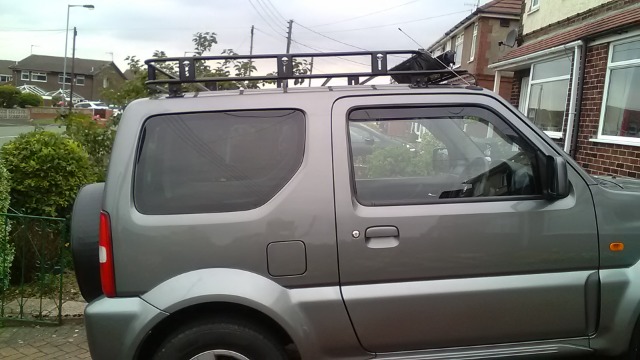

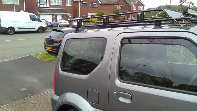

Thanks. It's called Dark Smoke and has a VLT of 15%.
I don't think it's going to be dark enough for your privacy needs, I would go darker. The first photo is taken with both side windows inline, so you are actually looking through 2x15%. One tint on it's own is a lot lighter, you can see this better in this photo taken at an angle so it's through side window at 15% and the rear which is Suzuki standard(no aftermarket tint).
I don't have any night issues at 15% and would happily go darker for privacy, in the region of 10% to 5%. The other film Halfords sell is Limo black at 5%, maybe worth a visit to take a look at how dark it is. You can always take it back and order your preferred VLT online.
