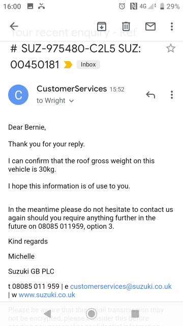

Last year, I asked my contacts at Suzuki to get a definitive answer to this thorny issue, making it clear that people weren't interested in the rating of the bars, but the maximum roof load itself, and that nothing less than an answer from the engineers in Japan will do. The answer that came back couldn't have been clearer - the maximum roof load, no matter how it's attached, is 30kg.
Like I said at the time when I posted this, you're welcome to dismiss it if you want - it's your Jimny, you do what you want with it. But we shouldn't kid ourselves, the people who designed and built it state that the limit is 30kg. Should they have put that limit in the owner's manual? It would certainly have made our lives a lot easier. Perhaps if Jimny gets revised as an N1 commercial, they'll have to do just that.
