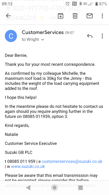

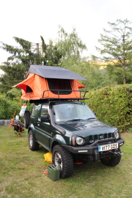

I love the concept of a roof tent - who wouldn't want to sleep high up and have their accomodation always available? However in reality it does limit what you're able to do.
Once you've parked and pitched the tent, you're stuck in that location and can't drive off without packing the tent away, so it's a bit of a rubbish solution for holidays where you want a basecamp to visit sights in a given area.
You really need a rack to take the weight of a tent - bars will give too much flex in the tent base. Weight combo of rack and tent will probably be double the recommended roof load of the Jimny.
People see the large overland rigs and want to replicate that, but the Jimny just isn't suited to that kind of setup.
A set of lightweight roofbars is probably the best bet for most people. I can strongly recommend the Yakima flushbars, as they're light (3kg each) and the adjustments can be locked into place, so it takes about 5 minutes to fit them when needed.
