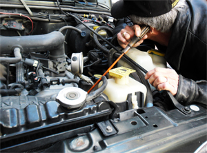

Put the gearbox in 2nd gear whilst it's on jack stands then go behind the car. Use a long screwdriver as seen on the picture to locate the source of noise.
Obviously check the differential and the end of axle housing not the engine! :laugh:
