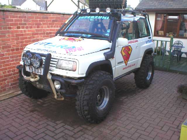

Replied by jackonlyjack on topic Help please, tyre size advice.....
I have run 225/75/16 on GV rims 235 will fit fine
I have +2" suspension and a 1" body lift
Only place they have rubbed is chassis front body mount brackets
Tried 205/80/16 special tracks even though they stand same height as 225 75
These made contact with the front panel under the headlights due to tread lugs
I also have +3" arms all round these make my wheel base 25mm longer than standard
So i would think you'll get rubbing somewhere with 235/70/16
If you choose retreaded tyres they will definitely catch/rub
What tyres do you have in mind ?

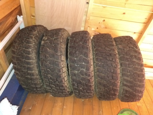

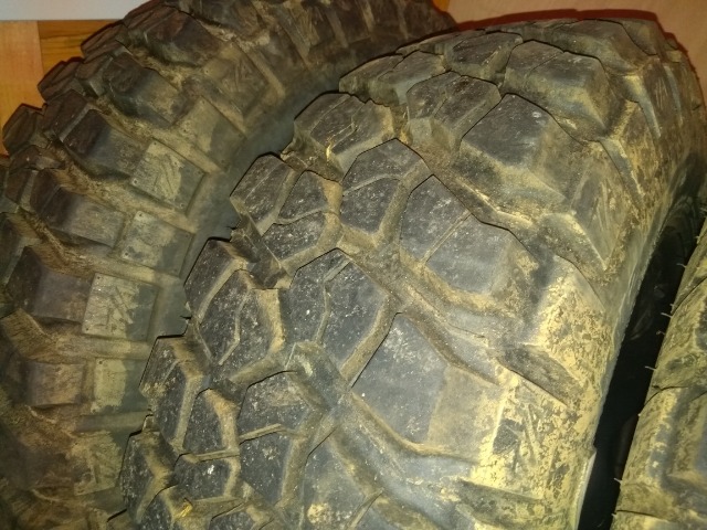

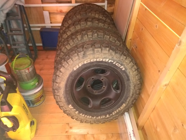

28 Jun 2020 19:11 #224186
215/65/16 insa risko will be same size as 215/75/15
But like Dave says bfh/grinder
I would sell my BFG KM2's
225/75/16
Set of 5 on GV rims balance beads fitted
225/75/16
