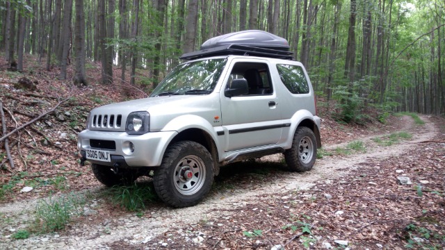

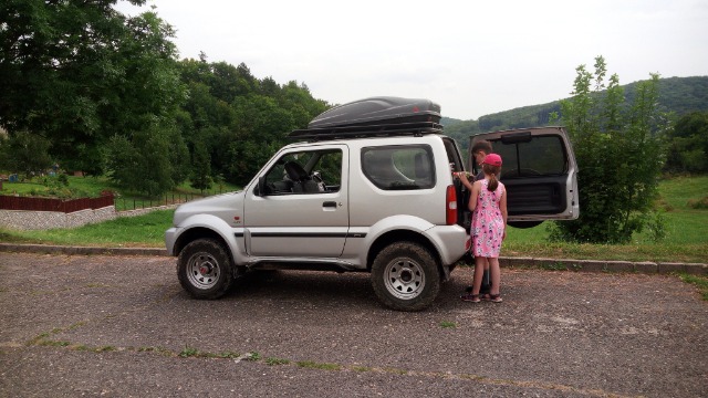

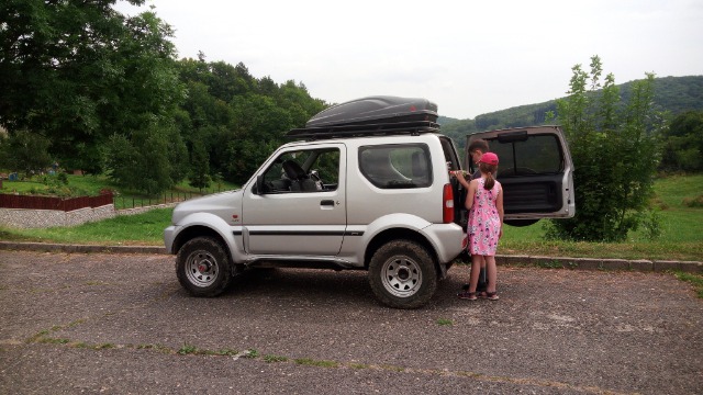

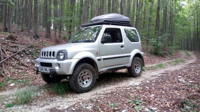

27 Jun 2020 18:57 - 27 Jun 2020 19:02 #224102
by HUN
TrailMaster 2" lift kit
ORE transfer box HD brackets
T-Max split charge system
Flo-Flex castor polybushes
Kumho KL71 tyres
AVM manual hubs
ORA radius arm guards
Push-fit breathers
This is my roof rack made out of mild steel and weights about 15kg. Strong like a roll cage :lol:
The box has 330 liters capacity.
