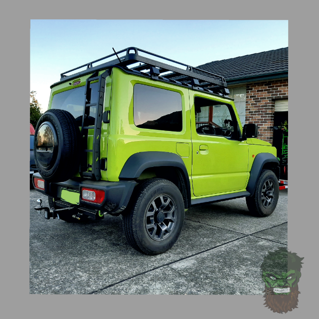

Hi All,
I am looking to see what could help with the huge amount of body toss left and right. I have noticed that the during high winds or bends, the body tends to lean one way or the other.
I have done some research and I have some mixed answers.
Would a 40mm , 50mm or even 60mm lift kit help with the suspension feel and comfort?
Wider tyres? Wheel spacers?
I do drive mainly on bad roads, very little city driving but I do a lot of highway driving.
Any thoughts or suggestions?

You are not going to like this but unless you are actually using that roof rack because of a genuine lack of space in the car removing it is going to be the cheapest way to improve the car's stability. If you are using it a lot especially with heavier or bulky items up top then slowing down and driving to the comfort zone of the car is again going to be the cheapest option. My gen3 is running heavy duty dampers and has one of the lowest side profiles in the community this side of a bikini soft top and even it is horrible in side winds not so much for lurching around on the suspension but just being pushed off course.
