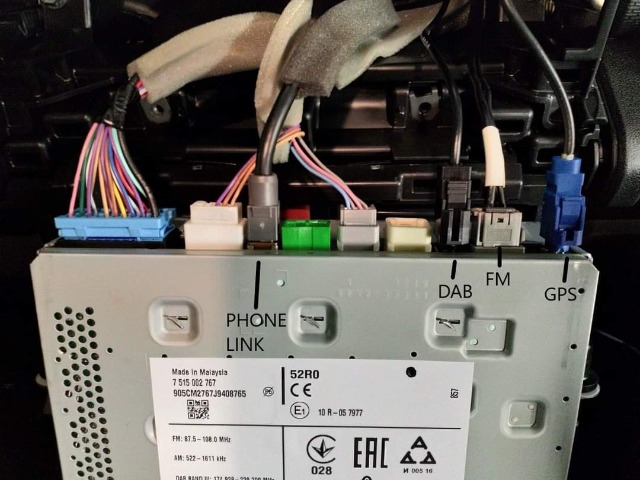

01 Sep 2021 18:00 #238126
Replied by mlines on topic radio upgrades
Someone once posted a picture of the connections on the back of the Gen4 radio/nav with the connections identified/marked up.
I cannot find it, can someone re-link or re-post?
01 Sep 2021 20:38 #238131
Replied by Soeley on topic radio upgrades
Did you mean this one Martin, or an actual pin diagram of the main block connectors?
The Green socket is for the reversing camera and the White socket (next to DAB) is for Aux Audio Input.
