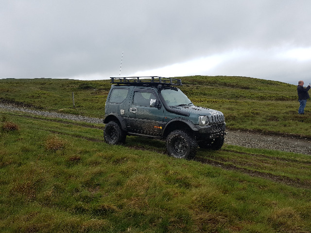

I think the 35kg refers to the "cheese" that the roof bars are made from.....I carried an 8X4 sheet of ply on those....then noticed what the mountings were made of.....it appears that having Jesus on your side works.
Moved to steel immediately!
Had 250kg on the roof.....interesting handling!
