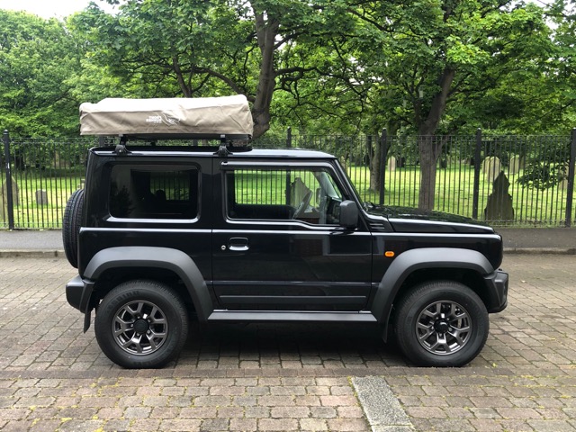

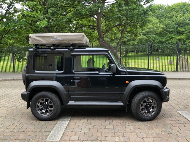

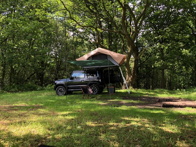

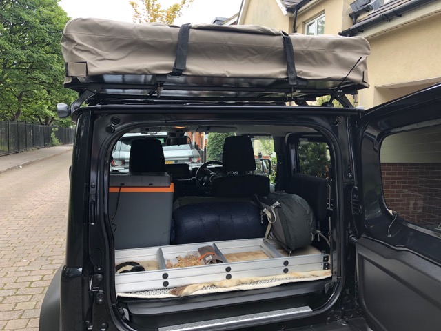

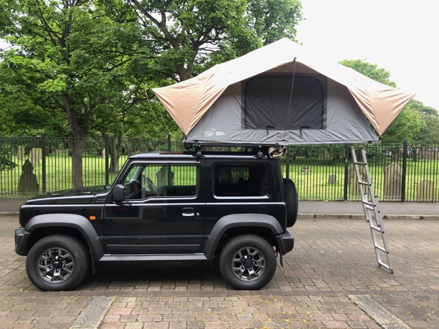

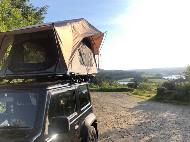

Really happy with the Front Runner Root Top Tent. Drives perfectly well imho. Sleeps 2 comfortable with ease.
Doing some mods to it for better fuel economy such as noting having the tent ladder attached during transit and also if you remove the stock mattress (which is uncomfortable anyway) and mount it off the rear, the tent slopes 2" down at the front. I've replaced the stock mattress with a 120cm wide inflatable insulated mattress and both that and the ladder fit in the rear of the Jimny when we're on the road.
On a kielder roof tent campingrecent trip I was hitting 39.1 mpg with the ladder removed and 31.9 mpg with it left on. I've got some quick release bolts to reattach the ladder when we arrive, it takes a few moments more. Not tested the fuel economy with the sloped front yet as I'd like to get some better straps to make the cover sit better. If it helps as much as I hope I'll get a custom cover made (their waterproof cover is ~4kg, I'm sure I can strip that back with something custom).
I use 2 Thule squarebars if there's only me sleeping in the tent and 3 if my wife joins. 2 does hold us both (150kg on the nose) but the sag on the rear bar is off putting. A front runner roof rack would be lovely at some point, especially with the quick release tent mounting brackets, as bolting it on sucks. Again though that's increasing the dynamic load. Very much interested in a 50mm lift and better suspension but inexperienced at this kind of thing and whether it would negatively effect the roof tent setup a step too far. What do you think of the trial master one advertised here in this instance?
Total weight up top while driving is:
• Ladder on and 3 bars = ~57kg
• No ladder and 2 bars = ~45kg
I've tried both and not noticed much difference is how it feels to drive but fuel economy certainly does differ. I'm not a fast driver at the best of times and chugging along, I sat comfortable on the motorway at 60-65 mph. Just dial driving right back and enjoy the ride. If you're going camping you're meant to enjoy the journey too so no rush.
Only been off road in a muddy field and woodland with the tent on and I was enjoying it so much I forgot I have the tent on. Absolutely love the Jimny and the experiences it opens up. As you say, it's the owners decision to weigh up (no pun intended) the pros and cons.
Added some pics if it helps.
Setup
Ladder attached
Ladder removed
Setup
Ladder attached
Ladder removed
