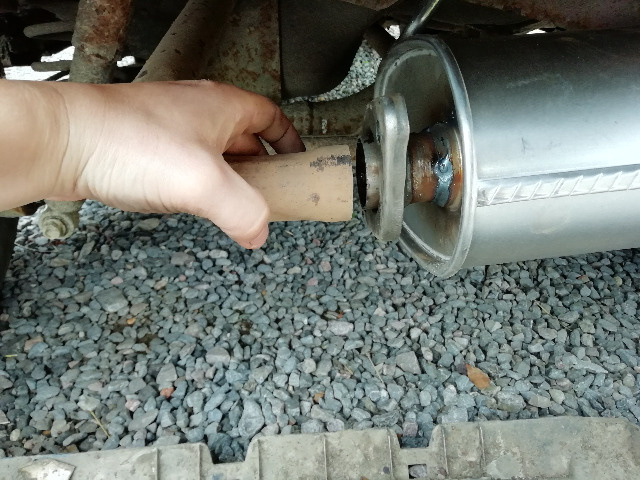

Hi everyone,
My backbox snapped off after the pipe rusted through and QwikFit wanted £170 to supply and fit a new one, so I decided to have a go myself instead.
As I've had to cut the old rusty clamp and a small amount of the midsection pipe off, the diameter of both remaining pieces is now the same. Is there a way to clamp them together or do I need to get it welded? I did buy a clamp with the exhaust but it's completely different to what the old one looks like.
I've attached a picture to show what I mean.
Apologies for the noob question - I've never changed any part of an exhaust before.
26 Jun 2019 15:23 #210320 by jackonlyjack
Replied by jackonlyjack on topic Exhaust Question
To be honest just buy a new mid section i paid 16 quid euro car parts
reason you will pay more to have it welded
  • Lambert
  • Offline
  • Moderator
  • Moderator
26 Jun 2019 15:58 #210322 by Lambert
Replied by Lambert on topic Exhaust Question
He's right. Paying for someone to weld an exhaust is prohibitively expensive for what it is.
