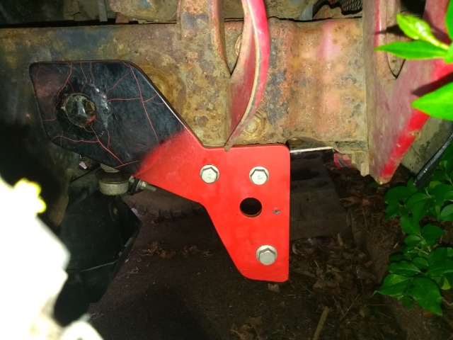

I needed one quick so I could compete in a RTV next day some 6mm plate and an old socket
Found a socket that fit into chassis cross member
Made a cardboard template, welded socket on a few bolts.
Been recovered with it
