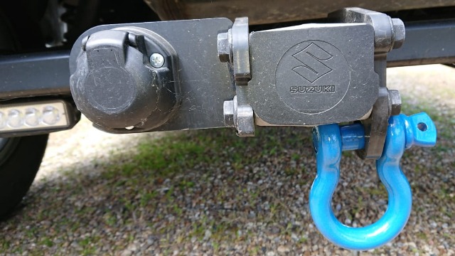

Towbar should be fine but those kinetic recoveries scare me. Perhaps it's better to have farmers tractor on call. Chris.

2. I will therefore need either 3 recovery points (two bolted or welded to the chassis rails at the front, and the tow bar fixture with a suitable recovery fitting), or 4 recovery points (an extra two bolted/welded to the rear - and no tow bar).
3. From what has been said, it would appear the tow bar (with suitable recovery fitting) may be the best solution at the rear - because it doesn't introduce any potential 'crushing' into the Jimny frame. However, this leaves the question of what to do in the case of a 'snatch from the front'.

Consensus is beginning to look like two recovery points at the front (fixed to the rails - and giving the option of which one to attach to), and tow bar rear.
