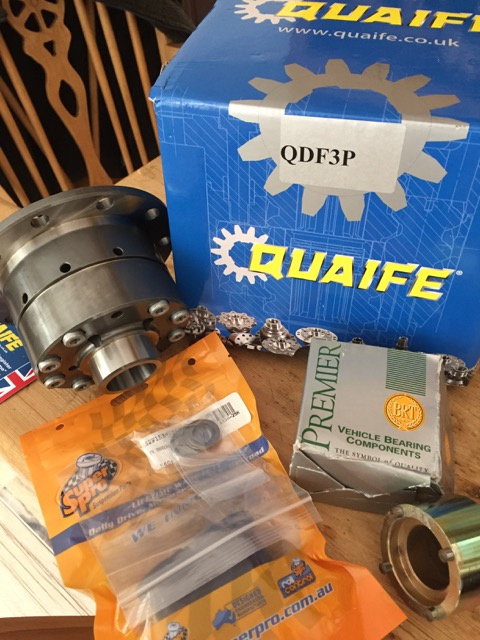

Welcome to the forum. Having driven a Jimny with a proper quaife atb in the back I can honestly say it is the best thing in the world. I am currently saving for my own one.

My 05' VVT is firstly a road car and the Quaife ATB is made for this, it transforms the way power reaches the road. You have to drive it to understand, I've tried to explain it's impact and failed. I have driven ATB's in four cars now and they are great in a tarmac tool of any type.
Off road it is very effective too, I do some pretty rough lanes on occasion and people comment on the cars ability.
They are a different tool to a locker and need to be looked at that way. If your mud plugging on off road courses or constantly driving really tough terrain (lifting wheels), an air locker is the way to go...
The ATB is fit and forget with a lifetime warranty, no special fluids, no rebuilds, no secondary air to fail.
It does have some negatives, even a Jimny can now induce a power slide in the wet........The line is easy to find and once you've spent a day or so playing about, its also predictable.
T junctions turning right uphill are also entertaining if the road has a lot of camber, it tends to induce a slide as the axle crowns the camber.
Drifting in snow is a ball, especially uphill through other cars that failed the climb..... only bumper high drifts can stop me.
So, without doubt the best money I have spent on my car and I would recommend for your brief without hesitation.
