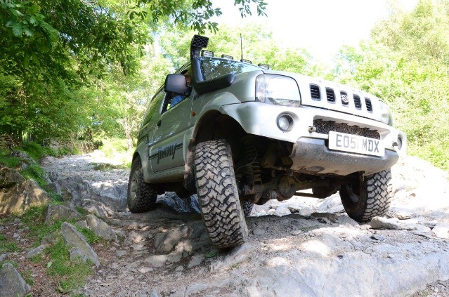

Approx 2 inch lift (+2 springs on the front and standard fronts on the rear) rear has another set of axle spring cups mounted ontop of the originals acting like a spacer. +5 rear shocks mounted on some homemade lower shock mounts that can oscillate +3 on the front. 4 inch lift radius arms all round with standard bushes in (it has literally had every form of suspension tried on it and this was the best combo as I like low as possible but it drives really well, nicer than standard really. 6.5 transfer box gears in a homemade cradle that's a hybrid between a jimnybits guard and a spine round the box. Heavy duty rear prop. 245/75/16 (31ish) tyres on grand vitara alloys that don't catch anywhere - had a lot of faffing with bumpstops etc. Homemade front recovery points and the bare minimum arch trimming really so mud cant get packed into the door. It does really well offroad but the transfer box will be coming out soon to go into my SJ buggy I'm building. Then maybe long term this will be made into a tubular offroad only toy too - All exciting stuff :laugh:

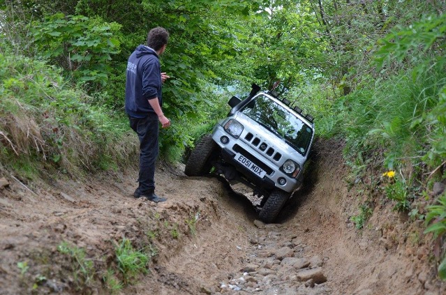

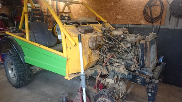

Further to Harry's reply there; some photos of the Jimny & Buggy...

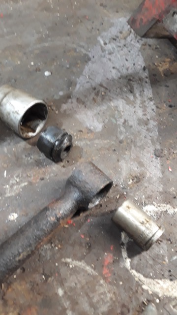

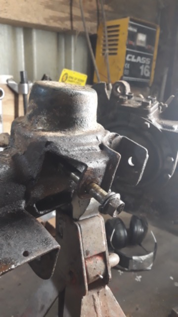

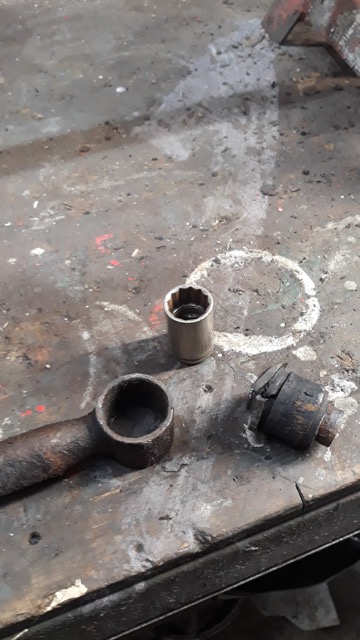

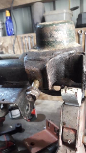

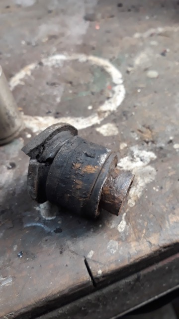

Panhard despite everything I thought the captive nut weld had not failed great afternoon in the shed

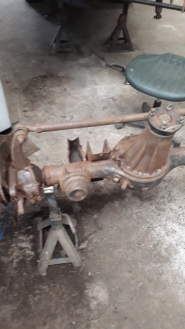

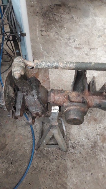

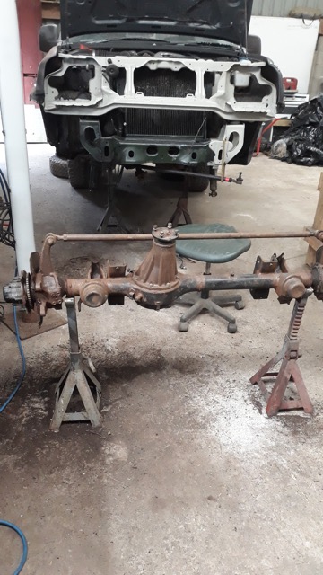

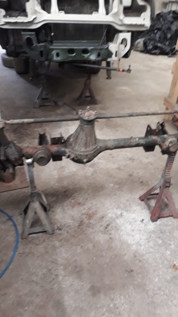

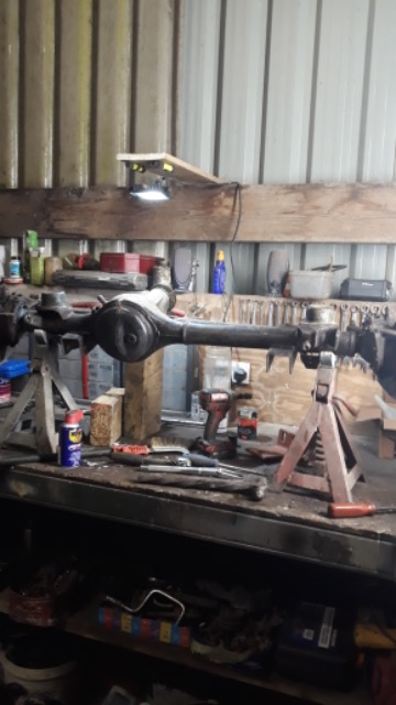

Started cleaning the axle this morning and going to be ordering ball joint bearings and seals. Glad I took it off wasn’t going to be safe heading up to Scotland in something on its last legs.
