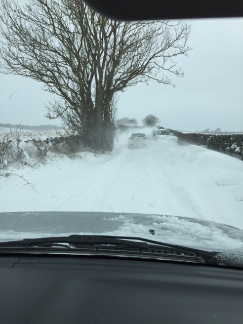

AT's and MT's will have the edge in deep snow, winter rated road tyres will be better on compacted snow.
Tyre choice is always a compromise, even when budget is not an issue. Big knobbly mud tyres will work their way through snow like no winter tyre could, but put that same tyre on compacted snow or ice and they can be laughably ineffective.
My KO2's hold snow in the treads and this helps with traction over icy patches,
Trying to drive road tyres in 6" of snow wasn't a good idea for these guys, the truck got stuck trying to go around the car.
I drove up did a three point turn, bussed up and took them a couple of miles to safety.
Drivers have as big an impact as tyres, picking the right line is just as important and knowing your limits.....
