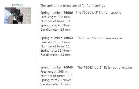

Sooo... I started my research and ended up at one of TomDK's old posts -
So from that I worked out with some more googling that standard front springs are 335mm long and wound from 10mm diameter 'wire', the rears are 288mm stock length and also 10mm diameter wire
Trailmaster +2" fronts are 368mm long (33mm longer) but wound from 12mm wire
And their diesel springs are 353mm long (shorter?) but wound from 13mm wire
Mine are fitted and I can't really take them off to measure them, but I got the vernier out and they are 13mm thick wire too...

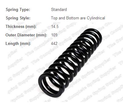

And I eventually arrived at these -
So I just bought one to have a look at, which turned up this morning -
These are the correct internal and external diameter coils to match Suzuki fitment but are 442mm long (too long, but from my research others just lop a coil or two off) and wound from 14.5mm diameter wire...
So, I think, these are a good match for the extra weight my Jimny carries, and I can cut them to the correct length and not have to run spacers on the front to make up the 4" suspension lift I want to refresh...
I'm considering buying another three springs, and cutting one coil off for the fronts to make them 400mm long, and 2 coils off the backs to make them 360mm long...?

Sorry to say Dave. But that's the price of quality springs. Be it Trail Master, Old Man Emu, Tough Dog, Dobinsons etc etc..
Zanfi springs are the same price.. Hope they match the quality.
Jimnybits springs are only half the price of that and in my opinion you usually get what you pay for.
The TM springs I had didn't sag a bit. When i sold them after 2 years they were still at full length.
If your Jimny is that heavy, I'd really consider the 3" lift springs from TM. They are in reality only 2" longer than standard springs. But made of 13mm wire and fairly hard.
