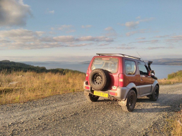

I had the same dilemma as you recently, wanted a lift but could only afford either a cheap full kit or spacers.
In the end I decided that the difference in performance between a cheap kit and spacer kit did not warrant the difference in price, so went for just the spacers and shock relocation brackets. Am very happy with the performance of these, I'm not doing hardcore off-roading / trials etc, but am offroad a lot up on grouse moors and overgrown forest tracks, and the setup suits me more than well.
So now if I do go for a complete suspension kit, I've got the opportunity to save for a good one, with Trailmaster being the minimum as I've heard good things about their springs (non-diesel) especially.

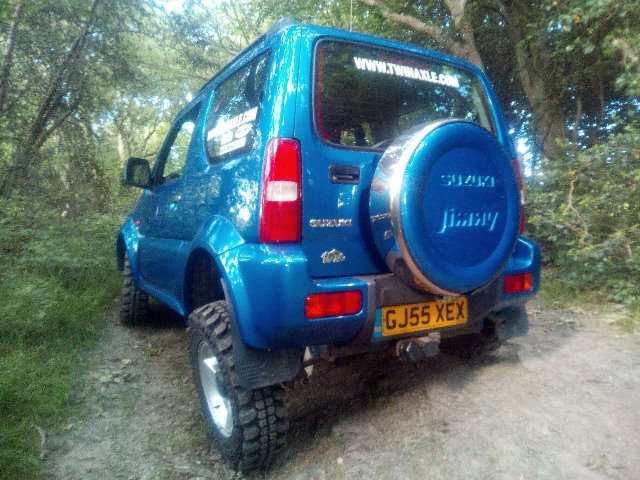

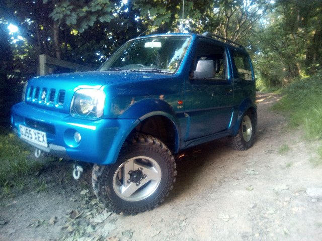

I have the 2" lift from jimnybits (pro comp) on mine. It works well off road at low speed. The jimnybits springs flex well but the pro comp shocks are way too stiff for road use in my opinion. As your suspension is still fresh I would go the spacer route.
Shame you are so far from me as you would be welcome to have a run out in mine for a test.
