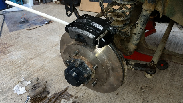

Not a guarantee.....but the carrier and caliper from a 2005 1.6 GV bolt straight onto a Jimny hub.....I only had a vitara disc to try though.....some idiot ordered jimny vents a year or so back as spares and never opened the box.
Crack on and have brakes which don't warp.
Luckily we have a GV to use the "Jimny" discs on!
