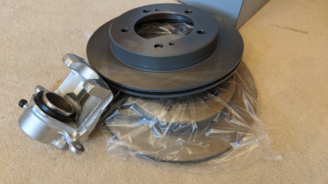

Martin posted in the 'what did the postman bring today' thread about receiving the calipers and discs for this conversion this week.
Martins goodies:

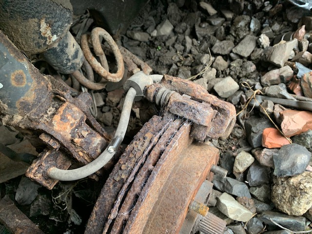

This renewed my interest in sorting out my brakes. I already have the discs (or so I thought).

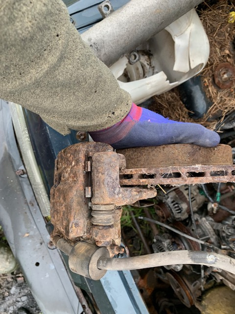

Trip to the local scrapyard where I knew there was a car with the right hangars on it...
Very rusty and obviously been sitting around ages as its all solid. £20 later and back home to try it on (obviously the old caliper is to bin).

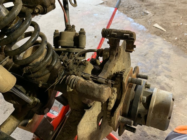

Hangar fits a dream onto the Jimny mounting points:

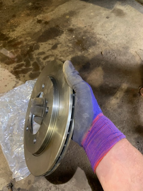

But the discs I have are for a vitara as it turns out (the hat isnt high enough for a Jimny)
So I need new discs that fit and the calipers to match.

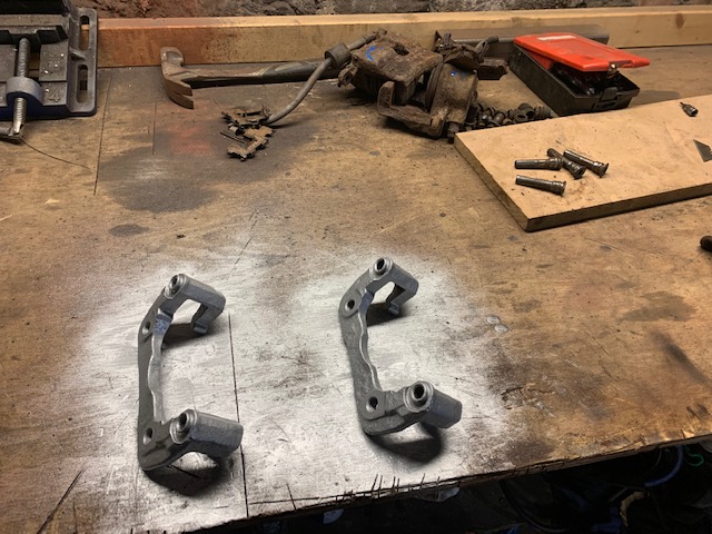

Cleaned up the carriers for now in readiness
If Martin is reading - can you post links to the ones you bought please?
