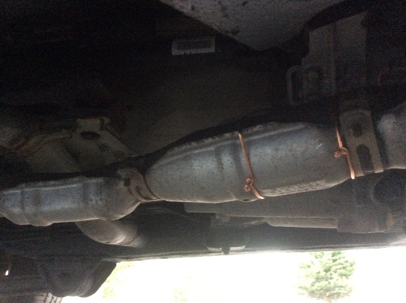

Just had a look under the Jimny, while the missus revved it up. Quickly found the culprit; a loose heat shield on the rear CAT. I've now fastened it securely with some copper wire from a set of old meter tails. Cost £00.00...result! Thanks Martin
