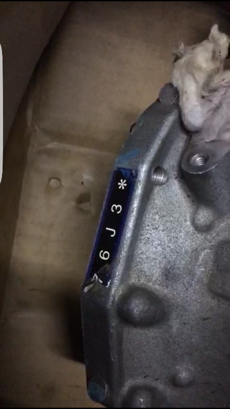

Gearbox code : 76j3*

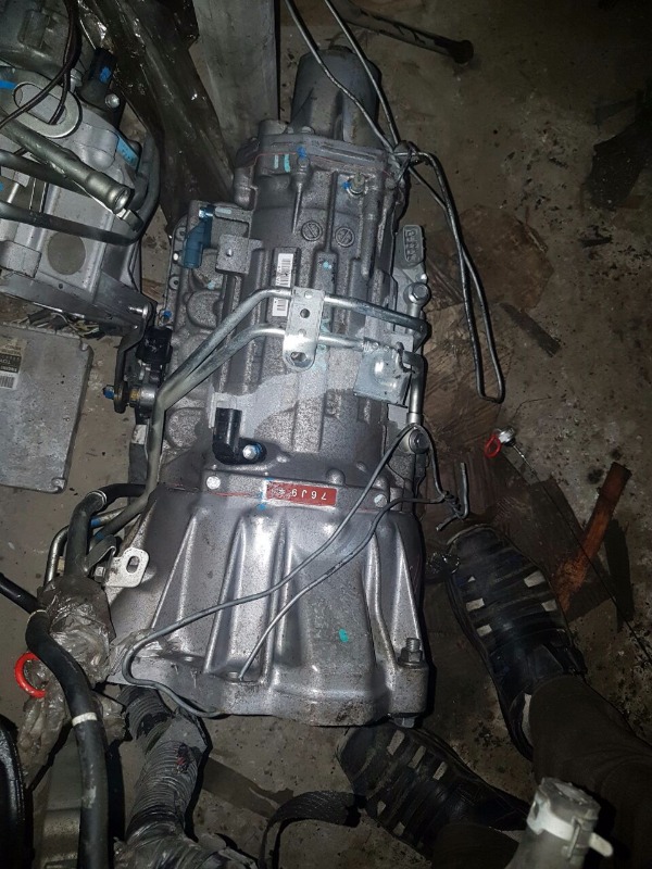

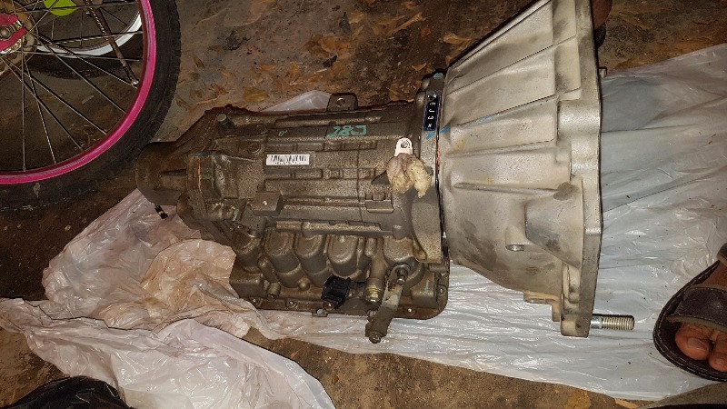

And here's the one i am going to replace mine with

So i have found one used gearbox in perfect condition which is all good to be replaced except one thing. It's of 2009 jimny's but with different gear code i. e. 76j9*
Seller is saying everything is same and it will work fine with your jimny but i want an expert opinion and more information about it.
So if anyone has any idea about the difference between 76j3* and 76j9* gearbox codes and any information about its replacement, please share with me.
I'll really appreciate a quick response.
Thanks,

www.bigjimny.com/mediawiki/index.php/Tra...ssion_gearing_ratios
Just from Google "jimny 76J9" it could be your AT with the code 76J9 is from a K6A engined Jimny.
Wich makes for a slightly different gear ratio see link above.
Might not be a problem but I have no idea if there could be other torque and rpm settings for when it will shift or something, I am not too well into the auto gearboxes.
