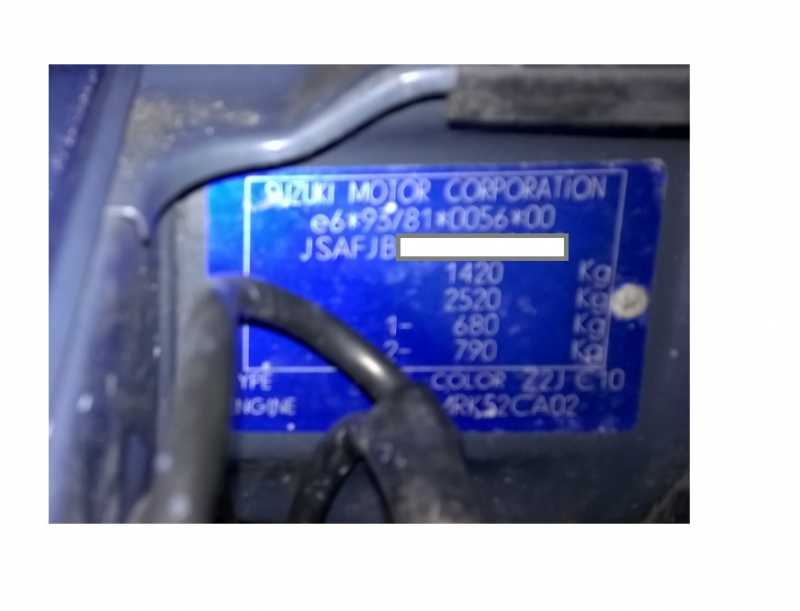

This Jimny is for a project but not an off roader.....it will be chopped around quite a bit as things progress. Having failed the MOT I need to get it back into a roadworthy condition to demonstrate the finished unit.
The MOT failure was mainly chassis based - up until 2 years ago a replacement chassis was available from Suzuki as a spare part - sadly they only service product in this area up to 10 years old
provided you can demonstrate to the DVLA that you purchased the new part they have no concerns with you replacing the chassis.
The VIN Plate is the identifier of the complete vehicle,
everything is related to that VIN, engine number and so on.......by replacing a spare part you are not changing the identity of the vehicle, just a spare part and as the page from the catalogue shows the chassis is a spare part.
I've built LR several specialist units for export, some with a changeover to LHD and have never had an issue with the DVLA over replacement chassis
