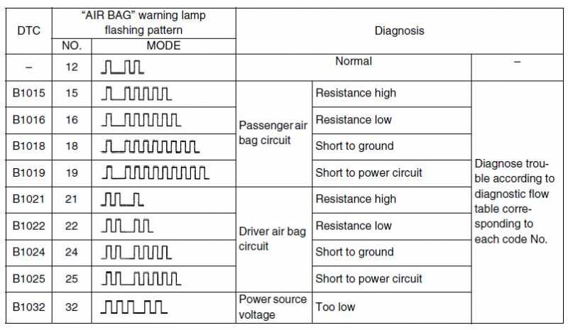

05 Apr 2016 11:04 #164896
by facade
Replied by facade on topic Air bag light
That didn't work :huh:
The monitor coupler is on the drivers side, remove that flap below the steering column ~(2 screws and pull backwards to disengage the plastic clips)
The coupler has just 1 purple wire and is part of the yellow airbag harness.
Ground this wire and the airbag light flashes the code(s) over and over e.g. flash....flashflash.............................flash....flashflash.... is 12.
12 means "Everything is Awesome" and is what it should say.
Then you switch off & on again wait 6 seconds, then ground the wire for a second, release for a second 5 times to clear the codes.
Mine just says 12 and clearing it does nothing, maybe it is supposed to flash 6 times and go out, and the manual is written badly :whistle:
