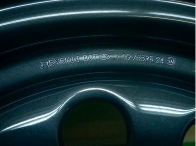

02 Mar 2020 05:16 #219264 by Lambert
GeorgeC wrote: Gentlemen, please check your Gen4 data, some of the sources are wrong!
Gen 4 is 5mm ET, not 22mm as quoted on jimnybits:
www.jimnybits.com/jimny/wheels-wheel-spa...lar-steel-wheel.html
See: www.wheel-size.com/size/suzuki/jimny/201...FXq_c96PT0caQlH82EE8
It is 2:00am here, so I got the magnifier out and had a look at the spare/rim, the Alloy is ET5.
I was given this photo from Japan for a Gen4 steel wheel rim, 43210-81A25-QC8 however, I cannot find the ET in the photo :
If it's a Japanese wheel make sure it is for the Sierra or wide Jimny not the kei variety as the latter is narrower to conform with regulations

02 Mar 2020 06:42 #219269 by Lambert
images.app.goo.gl/YSgEv4LexW88wKu99
Shameless appropriation from Google images.
