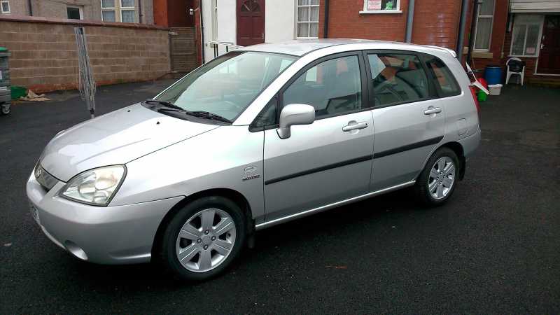

What engine should I use so it looks the same as the dohc
11 years 11 months ago #130985
by j999pre
Grey pick up Jimny
Replied by j999pre on topic Engine change
Liana. M16a either vvt or non vvt depending on which yours is
