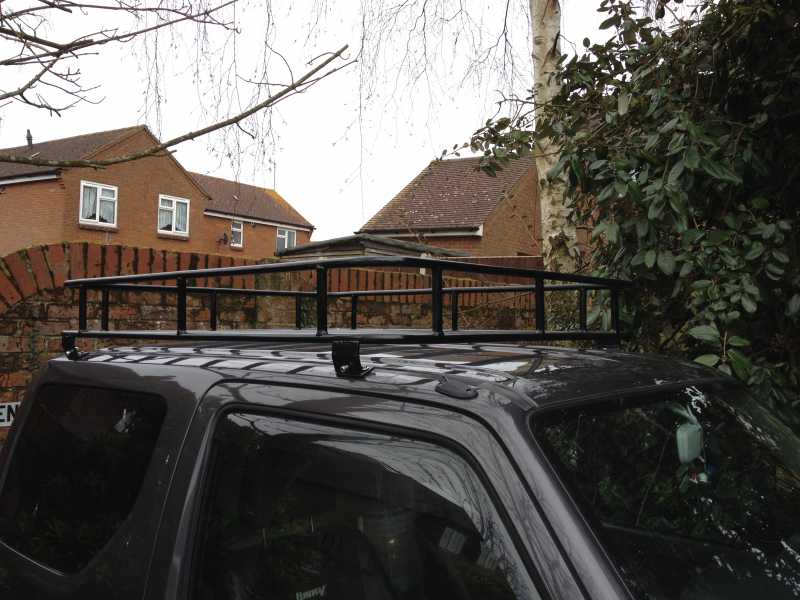

My neighbour made this for me
:) absolutely perfect for my needs , and still able to unbolt it in a few minutes .

Wish I had neighbours like yours :) been looking for a decent roof basket /laugage tray for ages

Daniel30 wrote: Wish I had neighbours like yours :) been looking for a decent roof basket /laugage tray for ages
I'll second that. Maybe this year I'll risk making one.
