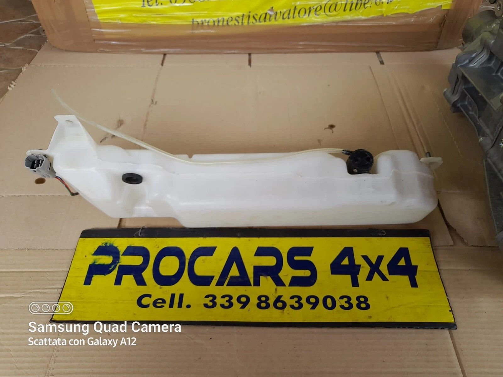

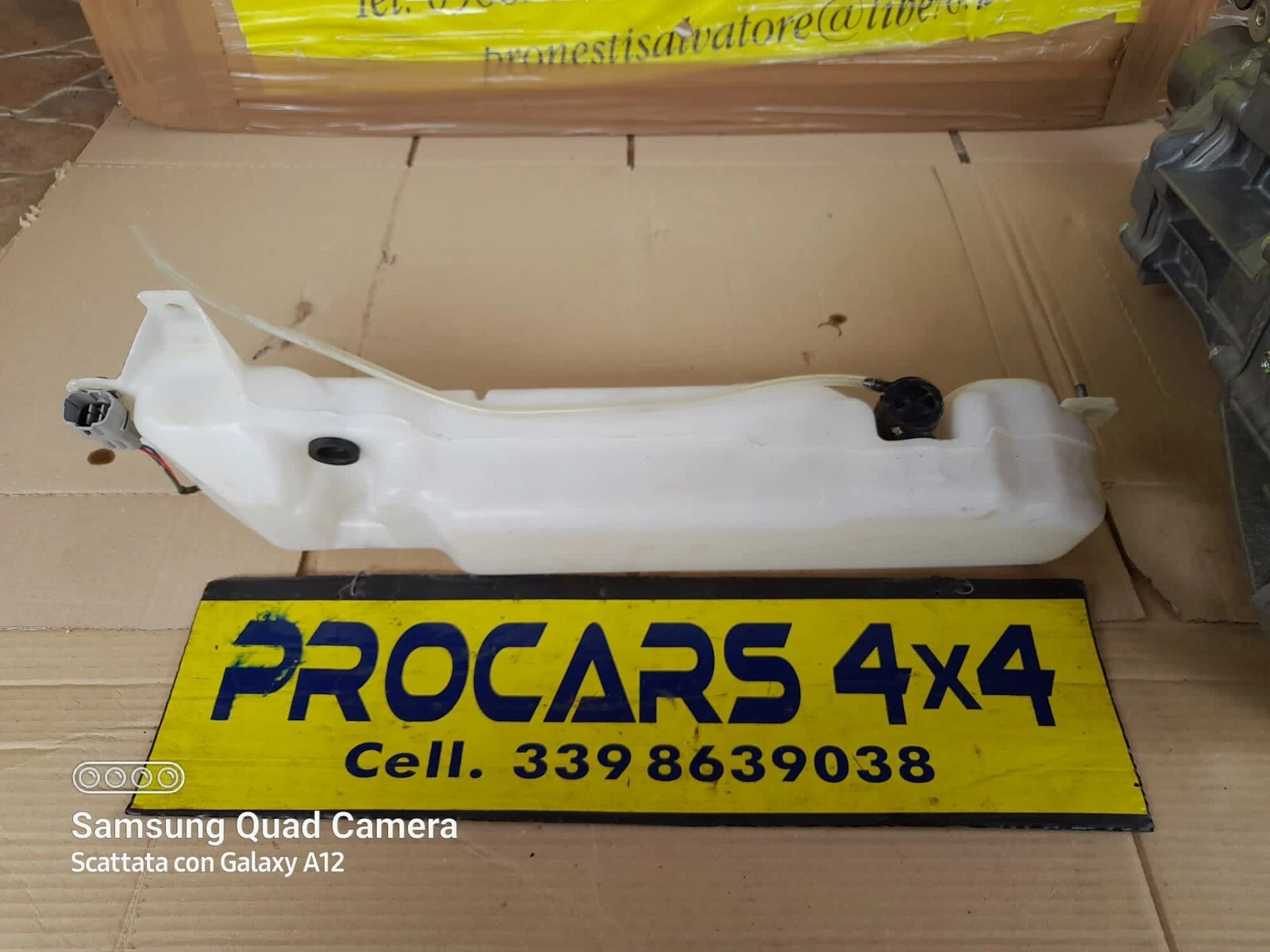

Reviving a dead thread, has anyone managed to do this?
I'm thinking of using a washer bottle of a DDIS Jimny, it fits on the inside of the wing so would free up a lot of space.

Darth, do you know if the mountings are already there or need making up?
