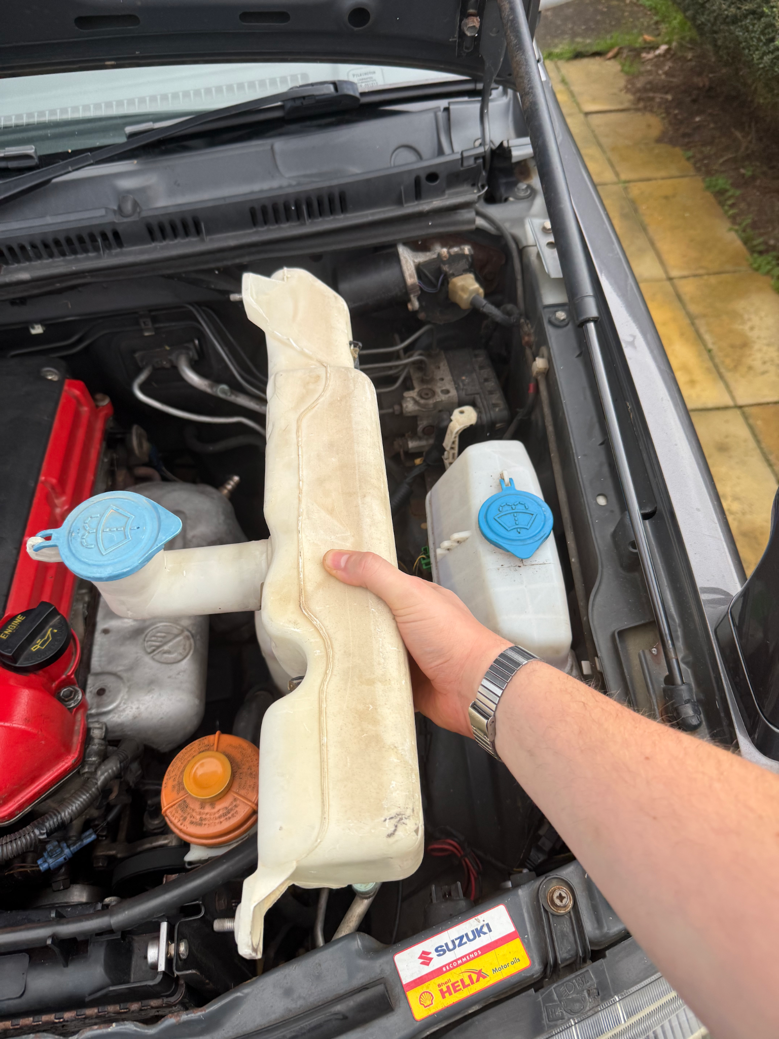

Possibly?
In the linked video above you can see the hole for the washer bottle filler, I'd assume the bolt holes are there too.
