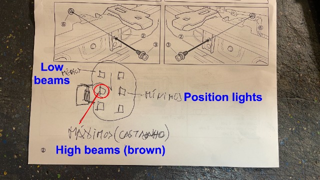

 Hi @Spitfire9, on the 6 pins lamp connector, take trigger current to the relay from the BROWN wire, it's the one for HIGH BEAMS.
