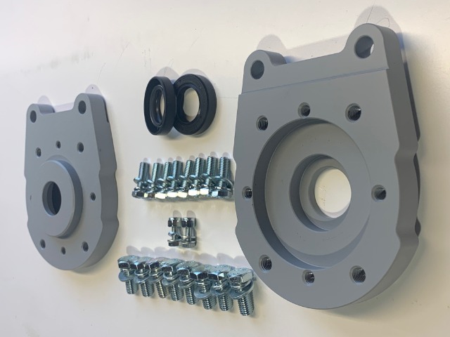

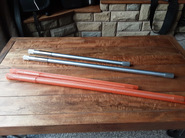

I make the adapter plates that go with these particular axle shafts (see Brett aka Maverick for the shafts)...
Replied by Riccy on topic What did the postman bring today
It adapts the rear axle to a 'floating' shaft and makes use of front bearing/hub assemblies to provide a much stronger and easier to replace rear wheel bearing. All 4 wheels now use the same bearing carrier and stub axle mounting arrangement, which is easy to swap and only a small spare part to carryWill you give us some pics of the build HUN what will floating axels do , not being smart just don't know.

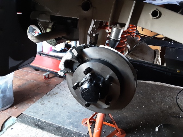

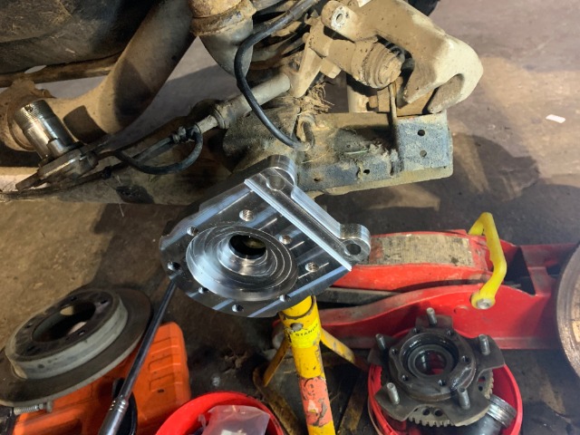

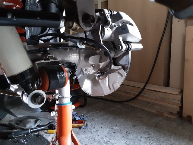

Here is some photo of my rear axle hub after the conversion has been done using parts from Riccy, Brett and Mr Suzuki.
Halfs-hafts only do torque transfer with this setup. Wheel bearing and ABS sensor have been relocated.
