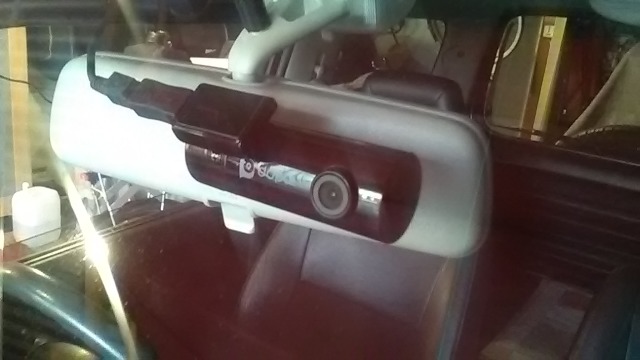

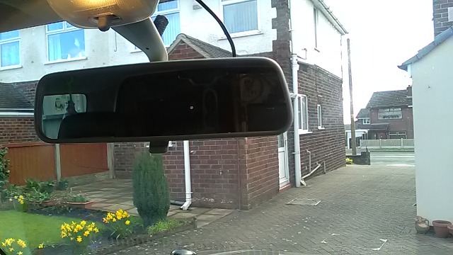

I installed my replacement dash cam in its proper location, pleased I can no longer see it.
New drivers view of dash cam.
How it looks behind the mirror. Nice unit (ddpia mini2) very easy to use with supplied app.

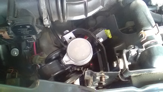

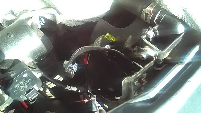

Could not get my STEBEL NAUTILUS "cOMPaCT" in the location of the old horn, so got the welder out and over engineered a new bracket.
All installed, very loud, just what I wanted.

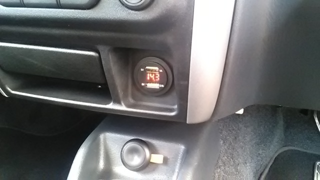

Finally installed the QC30 in place of the lighter, easy to fit and no need to disassemble the fascia as I had believed.
Nice to have the battery voltage on display, easy to see if things are going wrong.

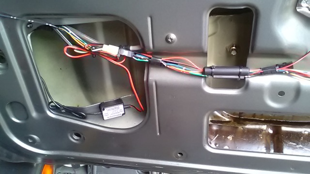

13 Mar 2020 16:12 #219824
by Scimike
Replied by Scimike on topic What did you do to your jimny today?

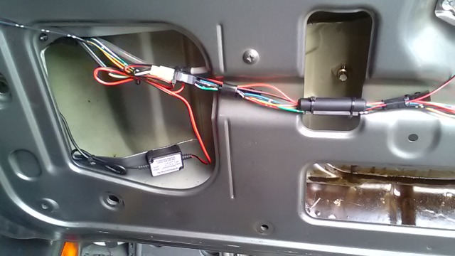

Well that was a lot easier than I expected. Now have hardwired feed to my rear door mounted dash cam. Managed to find a switched 15A live feed to the wiper motor which keeps all the wiring internal to the rear door. Fused Dash cam hardwire kit a £6 from eBay, fully bench tested by me before installation, can't fault it. If anyone is thinking of doing the same it's the Yellow / blue/ silver band wire to the wiper, it's a ignition switched +12v feed.
Smile, your are on camera..
