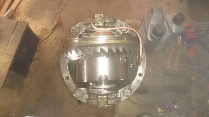

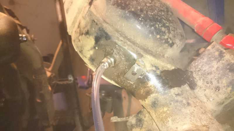

10 Jan 2016 21:21 #160133 by TomDK
Replied by TomDK on topic Re:What did you do to your jimny today
Did a diy front axle breather today out of parts I had lying around. Actually some old parts from a Watercooled computer project :)
Also almost done with the airlocker. Just need to cut the copper tube in correct length and install again :)
next thing is to reinforce the steering rod with some angled steel profile, now that the front axle is taken apart :)
  • jewi
10 Jan 2016 21:33 #160134 by jewi
Replied by jewi on topic What did you do to your jimny today
Daniel30 wrote: Snorkel fitted, HD transfer box brackets,HD transfer box mounts, engine oil,differential oil,transfer box oil all changed, spark plugs, air filter and oil filter changed
(gearbox to-do) fitted homemade diff breathers
Thanks to my mechanic Mark again for all his work (I did help a bit) :)
what did you use for the diff breathers?
  • Daniel30
10 Jan 2016 21:54 #160136 by Daniel30
Replied by Daniel30 on topic What did you do to your jimny today
Hi jewi
I used some black rubber fuel pipe it fitted a treat if I can find the left over bit tomorrow I'll measure the diameter :)
