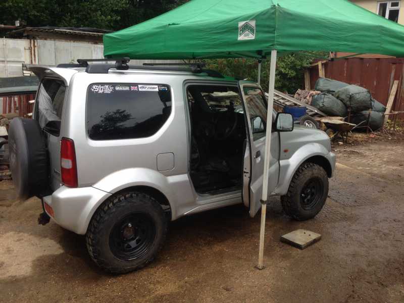

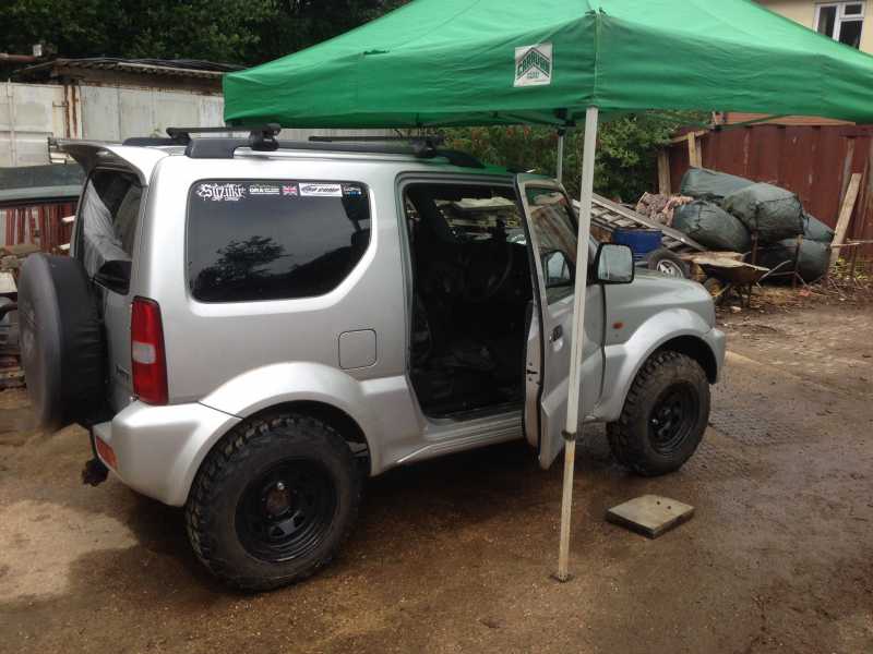

I made some new decals of my cars new Nickname & call sign.
The Silver Surfer.
I also installed my UHF radio & antenna
The Silver Surfer.

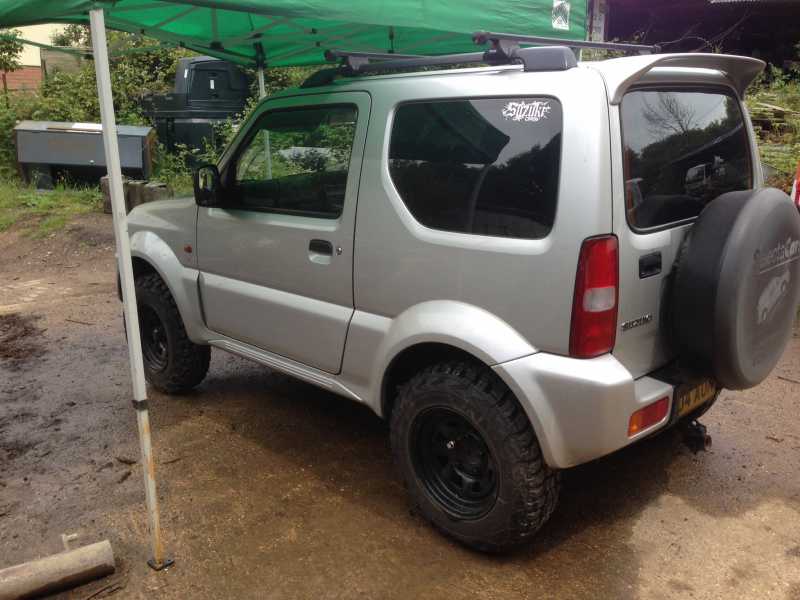

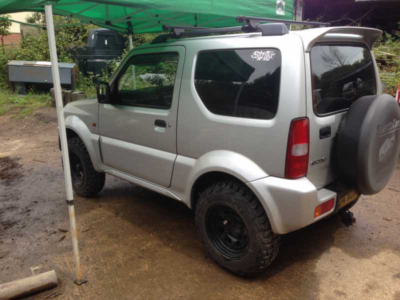

I found the source of the horrible sounding clunk from the passenger side rear:
All springs have now been replaced with +2" Jimnybits springs from Dave Jones
. I now have to fix a broken ARB bolt and a broken ABS sensor bolt, the later was done by a previous owner! then I have to bleed the brakes as I also had to replace a corroded front brake line.
