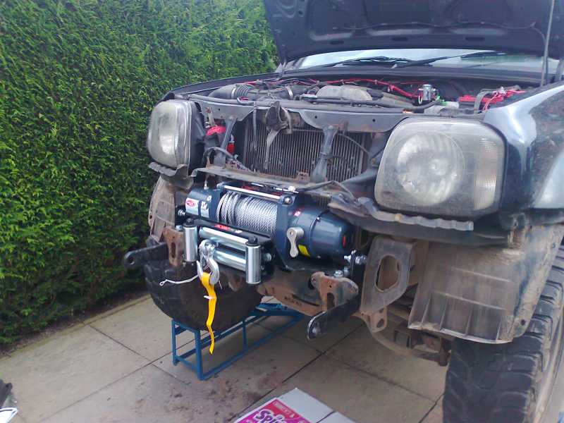

Started to fit my goodwinch goldfish and customised ORA front recovery points :whistle: . Just need to wire the winch in, refit my A bar and do some cosmetic work and return the truck to looking kinda normal . Here's a teaser for those who might be interest. Gonna be a few days before the finished job pics will go up in the my jimny thread

Nelson83 wrote: Started to fit my goodwinch goldfish and customised ORA front recovery points :whistle: . Just need to wire the winch in, refit my A bar and do some cosmetic work and return the truck to looking kinda normal . Here's a teaser for those who might be interest. Gonna be a few days before the finished job pics will go up in the my jimny thread
its blooming tight in there but looks a top job.. did you have any issues with the power steering pipes hitting the motor? can you post a photo if its not to late..
I had a problem fitting the same winch with the pipes, there was a bracket holding the pipes attached to the chassis I bent it In over towards the radiator to clear the winch motor

I cant say the steering pipes were the problem, the rest of it was :( took most of the day to get the mount plate and winch in the gap - cut away as much as possible, and even then there was on an inch or so to jiggle the winch and the plate over the dumb irons - even with an extra pair of hands. All i can say is its on and doubt it'll be coming off in a hurry
ne-crock - did you put anything behind the winch to stop the cable embedding itself in the rad? i'm thinking of a sticking a sheet of plate behind it, just to be on the safe side?
