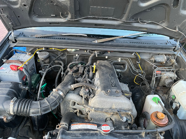

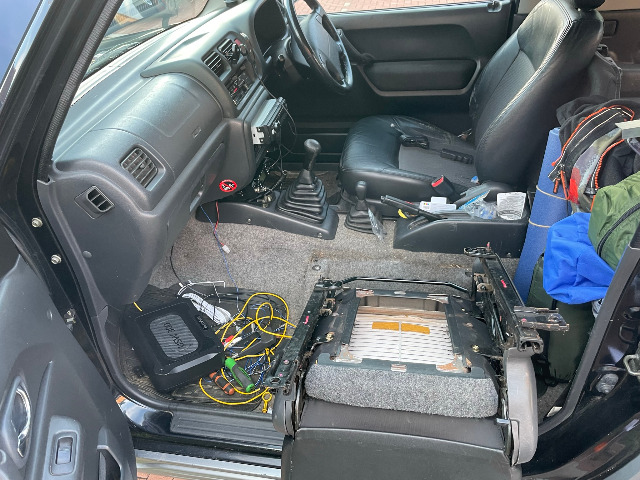

Yesterday:
Fitted a underseat subwoofer inPhase USW300.

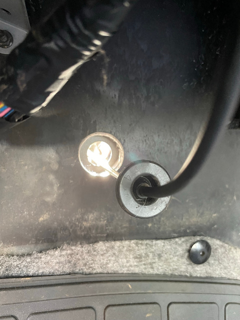

Some pictures of the placements of the sub. I ran the battery cable through the bonnet release cable hole. The grommet just pulls out from the inside and can just fit another 10AWG cable along with the original.

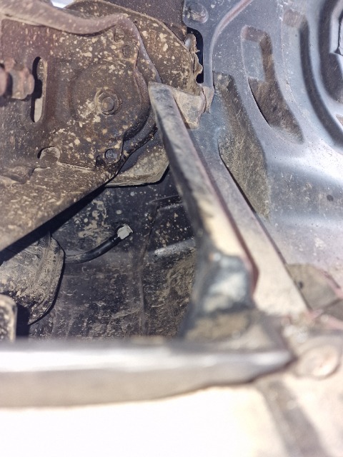

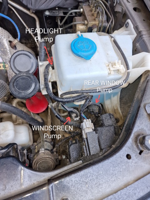

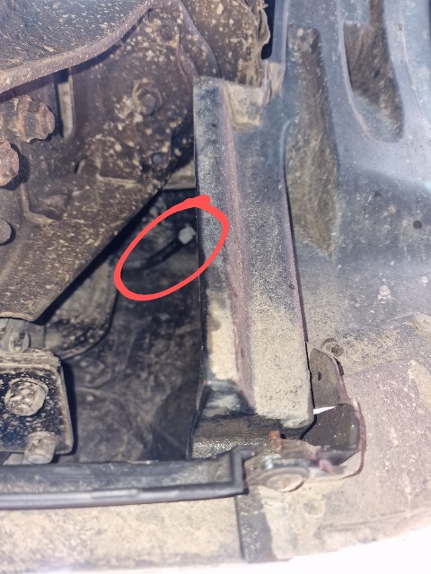

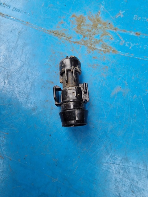

Today, I unblocked a headlight washer jet.
I noticed only the LH side was working, so knew it was blocked.

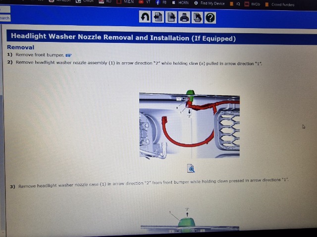

I checked the workshop manual and it said to remove the bumper, glad I crawled under first to see if access was possible.
Easy to get at once underneath.
It is worth clamping off the hose first, otherwise the screenwash just runs out like a tap.

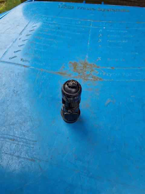

Here is the nozzle, the housing is separate and doesn't need removing.
