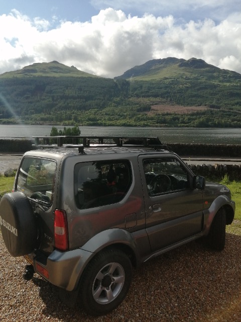

Swapped my dashboard mounted Elvis bobble head for Hula Girl bobble head. This is a nod to Oblivion.Also started a 1300 mile road trip without my caravan. Guess the location, no prize offered or implied.
The clue is they tested torpedoes here once.
Here's the Jimney.
Here's the Jimney.
