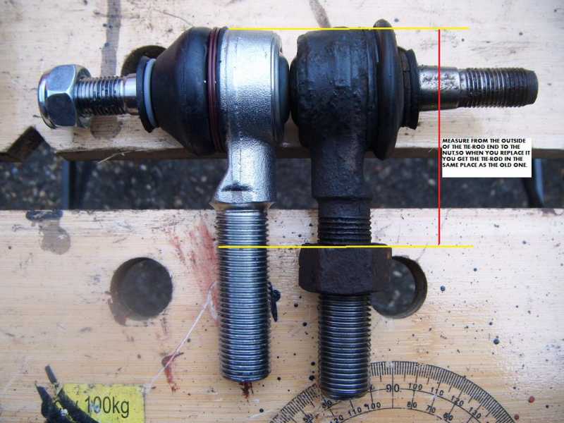

You should all so check you tie rod end, you have four on the jimny one may have so play in it this will also give you steering wobble.
l replaced one of the tie-rod ends after getting some death wobble at 45 mph' so it's not always the king pins.
On my jimny it's been the wheels balancing and two tie-rod ends, 40,000 miles on the same king pins not to bad.
As you can see from the photo of the tie-rod ends, they have two different length threads so you will need to measure as in the photo, from the outside of the tie-rod end to the locking nut, so it fit in the same place as the old one on the steering bar.
Hope this helps.
