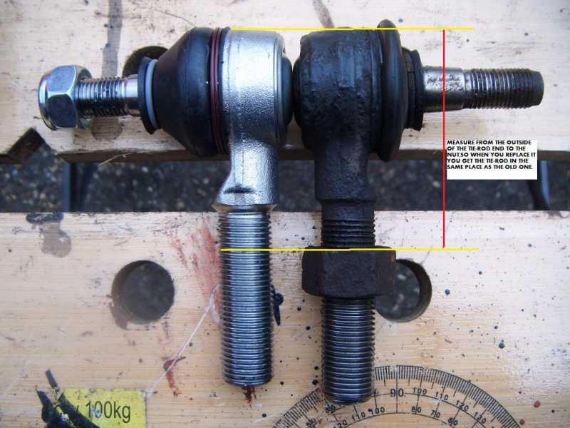

- dirtydogz
10 May 2012 20:28 - 10 May 2012 20:41 #39899
by dirtydogz
Replied by dirtydogz on topic Re: Fitting a Steering damper kit
You should all so check you tie rod end, you have four on the jimny one may have so play in it this will also give you steering wobble.
l replaced one of the tie-rod ends after getting some death wobble at 45 mph' so it's not always the king pins.
On my jimny it's been the wheels balancing and two tie-rod ends, 40,000 miles on the same king pins not to bad.
As you can see from the photo of the tie-rod ends, they have two different length threads so you will need to measure as in the photo, from the outside of the tie-rod end to the locking nut, so it fit in the same place as the old one on the steering bar.
Hope this helps.
Dirtydogz
Hope this helps.
Dirtydogz

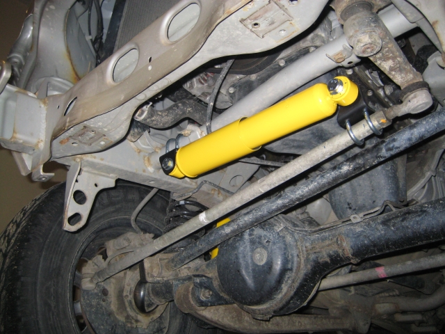

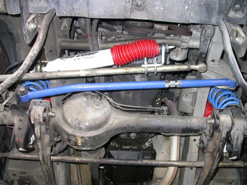

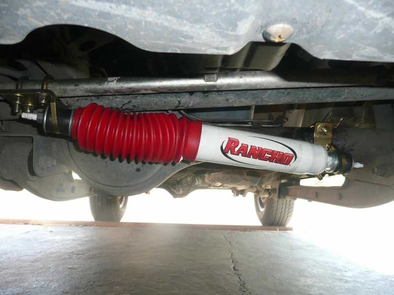

- supergaz
11 May 2012 07:17 #39931
by supergaz
Replied by supergaz on topic Re: Fitting a Steering damper kit
This damper kit is different from all of the above. I'm sure Bluejimny will be along soon.
It clamps to the o/s chassis rail across to the rear steering bar.
The top picture looks incorrect, it does clamp to the axle, but then to the rear steering bar up and out of harms way.
