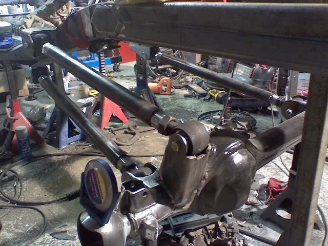

Where is the best place to get the creeper joints from price wise ?
- Blakey
05 Sep 2013 11:55 #82257
by Blakey
Replied by Blakey on topic Re: 3 link + panhard
Can get them from ORA or I have used inchworm and low range off road in the states and normally arrive in a few days.

Good day Blakely,
I am seriously looking into doing a 3 link. I would love to get some more info from you.
Why do you recommend the creeper joints over the Jonny Joints?
How long do they last? My current rose joints don't last 4 months. The second they get dirt in there, they are done. I would love to do a 3 / 4 link with rubber bushes. Only reason Is I overland and do a lot of long buddy trips with the car and I cant afford new joints every 6 months.
Does the 3 link not put unnecessary stress on the diff?
