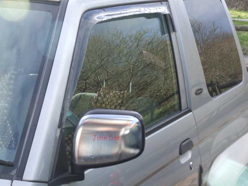

Never done this before (though often wanted to) but I had a set of deflectors that were enormous so this week I cut them back about 75% with a Dremel. Now they are just big enough to keep rain out with the window slightly cracked open. I followed the line of the tinting; I have seen better but at least it works.
They were originally stuck on and had clips; I spent ages removing the sticky residue on the doors. I left the residue on the deflectors for thickness and then I replaced them just using the clips.
