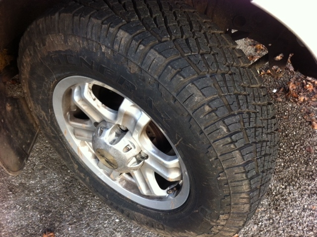

Great, I'll give that a try, my only thought is will this not cause me to have more lock no turning right or left if i start rotaing the steering bar? As this will extend or decrease the distance between the power steering drop arm and axle, has any one done this and had any side effects at all?
I also have a wobble now occuring at anything over 45mph, but not all the time, only on rought roads it appears, I hope this will just go once the tyres have worn a little.

If you can imagine the CAR not the tyre going at a constant speed with a 15" tyre!
Now,just to be silly, if you fitted a 10" mini wheel at that same constant speed the wheel would be turning faster so the speedo would be saying you were going much faster although the car was doing the same speed as before.
The reverse is obviously true ,fit a bigger tyre and it will be turning slower at the same constant speed.
Those with larger tyres will have to watch speed cameras etc but thse on standard tyres will be ok if driving at the posted speed limits as you are almost certainly under the limit
Hope that helps

All speedos under read by 2/3 mph. This is to allow for tyre wear and the different types/makes of tyre. As the tyre wears the wheel will be turning faster so the speedo will actually become more accurate when you have no tread left.phippj1 wrote: Thanks dirtydogz for the link, but it doesnt make sense, surely if you fit a bigger tyre to your vehicle, the one wheel revolution will be bigger, so when your speedo says your doing 70 youll actually be doing more, but this link says differently and says if you fit a bigger tyre to your vehicle when you speedo says your doing 70 youll actually be doing less, I dont understand it
Hope that helps

I've got a set of BFGoodrich ALL Terrain T/A KO2 tyres 215/75/15 on the way to go on a standard 2001 Suzuki Jimny. Shall I expect any problems fitting these?

I fitted them with no problems at all on standard jlx alloys. Went to 30mm spacers and have the tiniest of catches at parking speeds in reverse at full lock.
Cracking tyres, great on all but the muddiest of lanes and good on tarmac. They also seem to have brought my speedo inline with roadside speed cameras.
