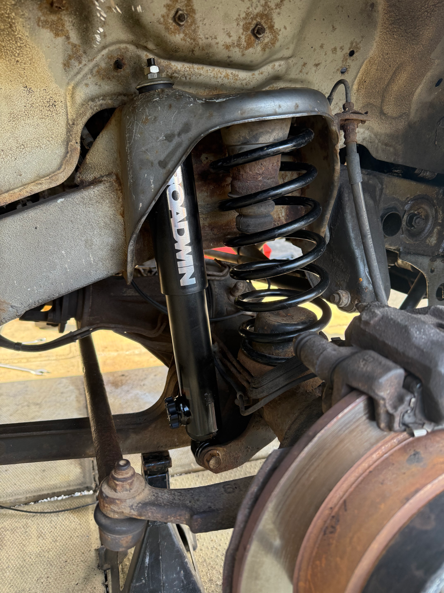

02 Sep 2025 17:03 #261828
by Darthblaker7474
Replied by Darthblaker7474 on topic JB43 Shock Question
If you check
my thread
you'll see I've swapped mine out for
APIO Roadwin
ones.
I've not tested them properly yet however I can confirm they were miles better than what was on the car originally. I've got them on the highest setting (14) atm and there's a marked improvement in handling (this caught me off guard when changing lanes on the M5 a few weeks ago, didn't realise it was so snappy!). I will have a tinker around with them as I could probably get the comfort to something better, maybe even bigger springs may help.
I'm not sure what the roads are like in Canada, however around here (local roads near the England-Wales border) it is like driving on the surface of the moon.
