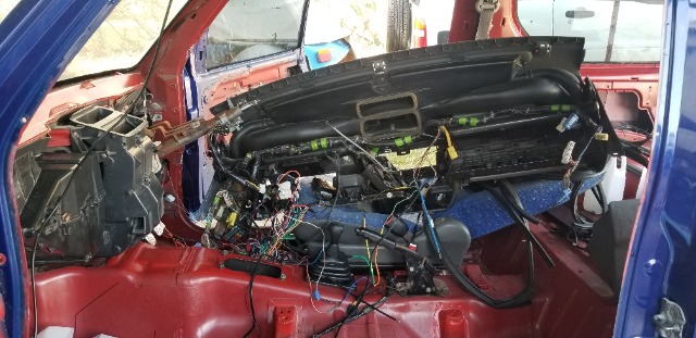

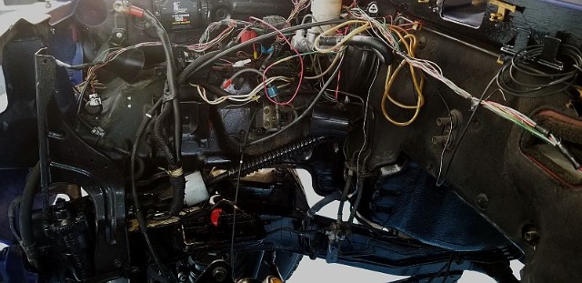

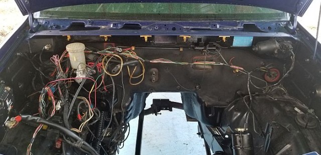

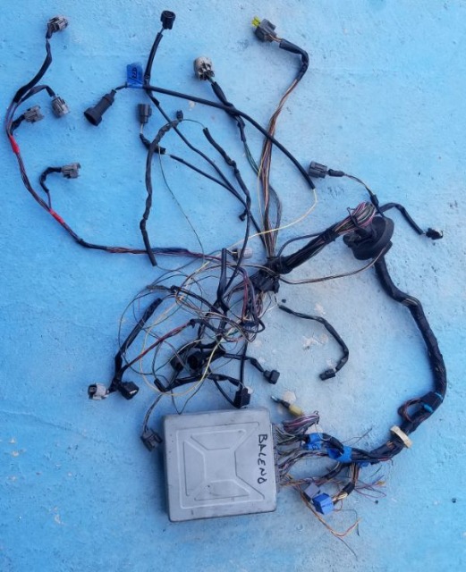

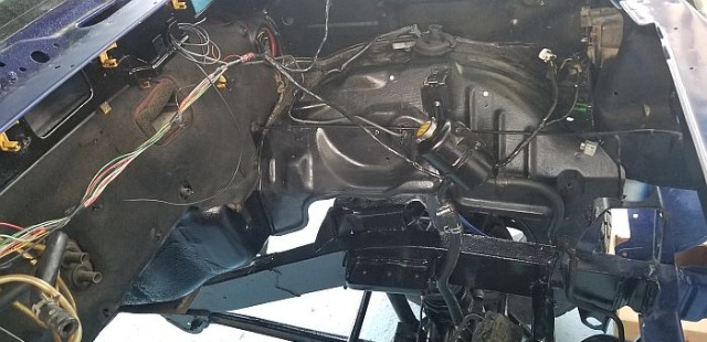

I am using the Baleno engine harness and ECU with my G16B swap. I bought a complete working car to get the engine, wiring harness and ecu to do my swap.
We stripped the Jimny wiring right out, separated the G13B engine harness wire by wire leaving behind whats needed for the ECU.
We then separated the G16B engine harness from the Baleno and then I will integrate and tie that in along with the crank sensor and some other inputs into the Jimny with the ECU. Doing it this way will ensure that we get the maximum power out of the engine buy using its own ECU.
Its the long way to do it, but since Rhinoman is not remapping any longer, it was the next best option.
